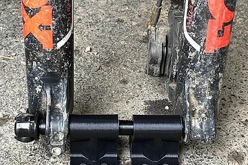

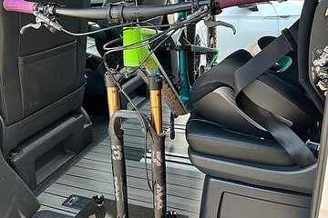

My boyfriend and I were on our way to Lake Garda and while loading the bikes (into his Seat Alhambra) we came up with the idea of mounting the bikes better and more securely in the car - so we designed this bike holder and 3D printed it the evening before we arrived.
This enabled us to transport our e-bikes safely in the car in an upright position (with the front wheel removed). The fork is fixed quickly and easily with the original quick-release axle.

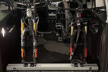

We used SPAX screws to mount this bike fork mount on a wooden board (be sure to use washers when using countersunk screws!), for the other variant we mounted it on aluminum profiles (aluminum profile 40x60 or 40x80 from a local hardware store). Some also use so-called airline rails or wood, screen-printed or multiplex panels)
The diameter of the axle can be
5mm / 7mm / 9mm / 10mm / 11mm / 12mm / 15mm / 20mm be
or also a special size as desired
-> please specify the desired diameter :-)
The bracket always consists of a SET / 2 individual brackets, so the width can be adjusted variably, regardless of whether the wheel is with or without Boost Standard . . .
Dimensions / measurements:
The arrangement of the holes on the base plate is 40 x 20 mm.
The fixing / through holes have a diameter of 6.4 mm
The dimension of the lower edge of the bracket to the center of the axle hole is 42 mm
One bracket is 45mm wide
